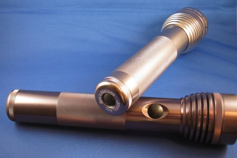

I'm starting this thread after coining this name (sorry if someone else has already used "The MaxBlaster" for another light) to post about a 2D Maglite mod that I bought from Mad Maxabeam, after making sure it was ok with him. I have no interest or relationship with him other than buying some of his custom made lights, and enjoying our PM's back and forth.
For a while, I was unable to get one of Mac's Torches after seeing the much publicized YouTube video, so I got a 2D model from Mad Maxabeam. Both lights used the Osram 64623 100W bulb and 14.4 v NiMH battery (12 cell) packs. The USL group buy project is another variation on the theme, but uses a different bulb and other components.

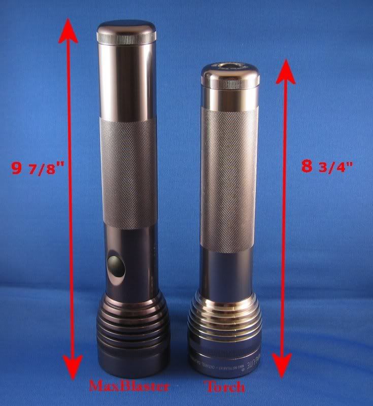

I was very happy with Mad's light, until I got one of Mac's Torches. I then noticed Mac's was shorter and brighter, as well as putting out more heat. I did find that I needed two hands to push Mac's tailcap button, but otherwise it just outperformed Mad's. I think it must be due to the lower resistance in how Mac made his, including the tailcap switch design...so BIG Prop's to Mac !

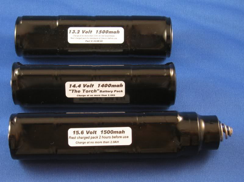

Quite frankly, my Mad 2D model was becoming a shelf duster....until he came up with a new idea in response to my PM's. Today I got a new design from MadMax, where the key is having added a 13th battery. This 13th cell brings the pack voltage up to 15.6V....and what a difference that extra battery makes !!!
I don't yet have an easy way to do comparison beam shots for such power lights, but you can be sure that the new "MaxBlaster" 15.6V 2D light is significantly brighter and easily puts out more heat than either of the two previously discussed lights (& verified with my own fancy fireplace newspaper test).
There are pro's and con's with both lights, as is usually the case with anything custom built. Mac's Torch is just over an inch shorter, and has a silky smooth operating tailcap button. Mad's MaxBlaster has the new higher voltage pack (brighter & more heat output), and by keeping the stock side button, it allows easy one hand operation which I prefer.
The craftsmanship of both lights is superb....and use the same bulb and reflector. Anyone should be totally thrilled to get either one of these lights....but Mad has more than made up for the lower resistance that Mac achieved, by simply adding more power.

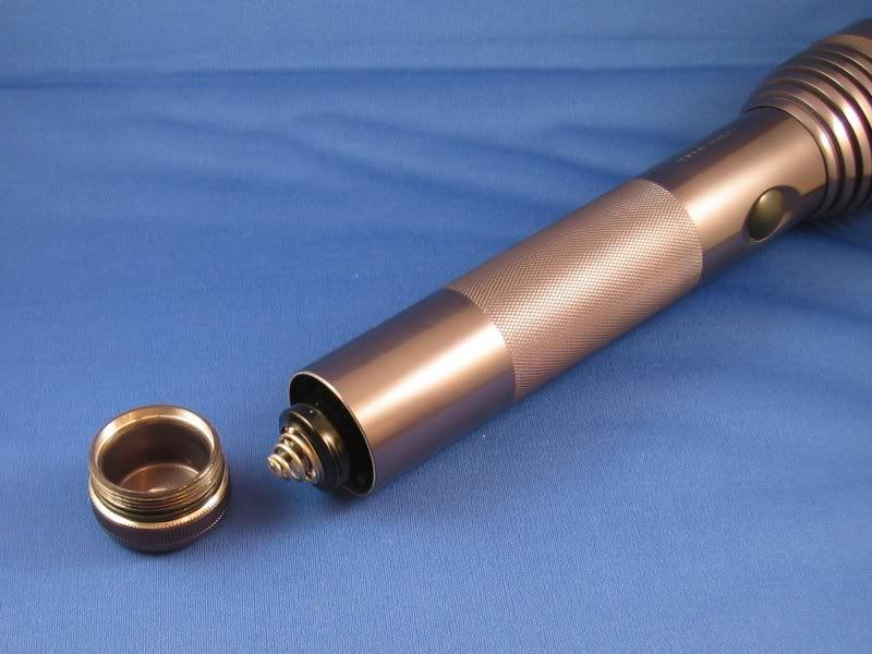

He obviously added the extra battery at the tailcap end to keep the 2D size, and now includes the spring as a part of the new battery pack. Quite ingenious IMHO, and it fits easily and perfectly in the same light with the normal tailcap spring removed. (The above 13.2V pack was also from MadMax to be used with the Osram 64625 or 62138 100W bulbs which reportedly have a nicer color and less artifacts...and which I plan on using with a new 3" reflector head coming soon.)
Hot off the charger, this new 13 cell battery pack was about 19.2V (!!!), but should be rested for 1-2 hours until the voltage is in the 18.4-18.5V range to avoid flashing the bulb. The previous MadMax & Torch 14.4V battery packs end up at about 15.9-16.2V after sitting a few hours...so you can see the advantage of The MaxBlaster.

Was a sping tail-cap mod done on Mads unit.
On the previous 14.4V battery pack version, yes there was a heavy wire soldered to connect the bottom and top of the tailcap spring.  However, as my images show, on the new 15.6V battery pack, he put the spring inside the end of the battery pack...but it still does have a thick wire coming from battery pack to end of the spring to further reduce resistance...which you can see in my photos.
