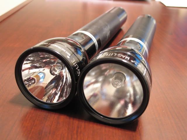

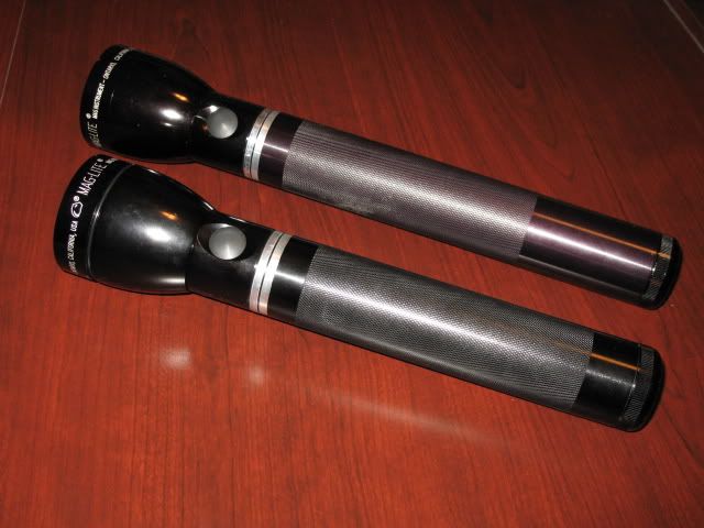

Little Mac  -  Super MagCharger Torch
(Started off being called the Big Mac   but   this is the Big Mac Here! )
MagCharger Cutdown and Tri-Bored for 12x IB1400 Cells
By:  Chris Maclellan    cmacclel
-100w 64623 Bulb
-Custom Charger with Universal Charger
-Custom Bi-Pin holder
-FiveMega L. Stipple modified reflector
(Macs Photo)
(Macs Photo)
(Macs Photo)
(Macs Photo)
MagCharger60 (Stock MagChager with WA-1160 bulb upgrade vs Little Mac 100w Torch)

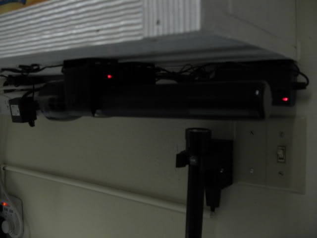

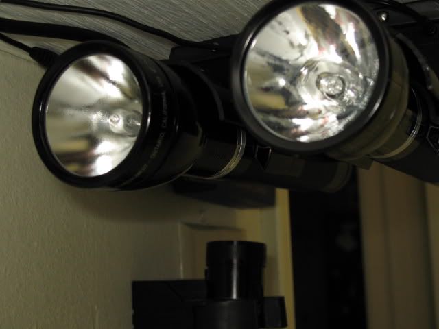

Notice the Smart Chargers temperature sensor wire laying on Little Macs back while in the cradle...

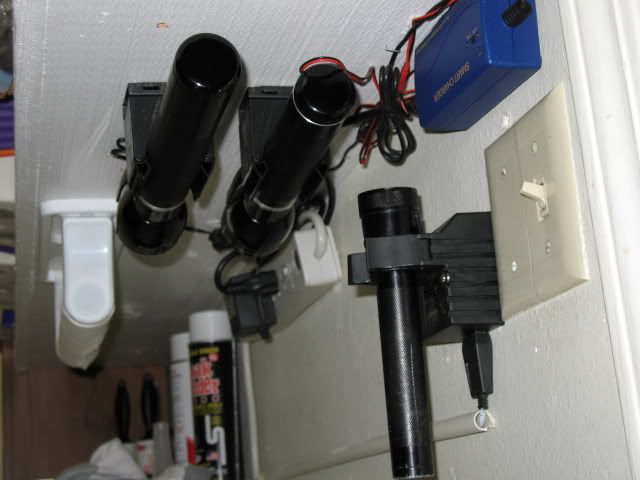

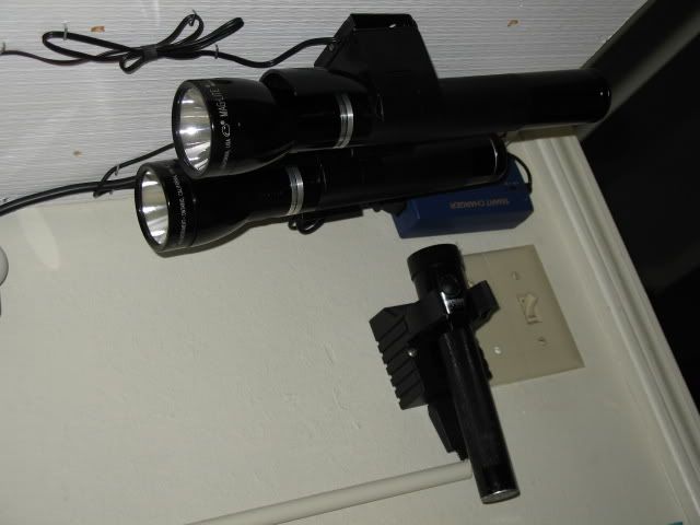

Charging Craddle Ends trimmed off so lights can be moved forward & held in place Off Charge, Power can be cut also with Power Strip for Safety...
The Smartcharger Charges the 14.4 volt battery pack up automatically . Only way to fly!  8)
Stock Mag cradle, left, will slow continuous charge & stay red; the modded smart cradle, right, will fast charge & turn green when finished.
