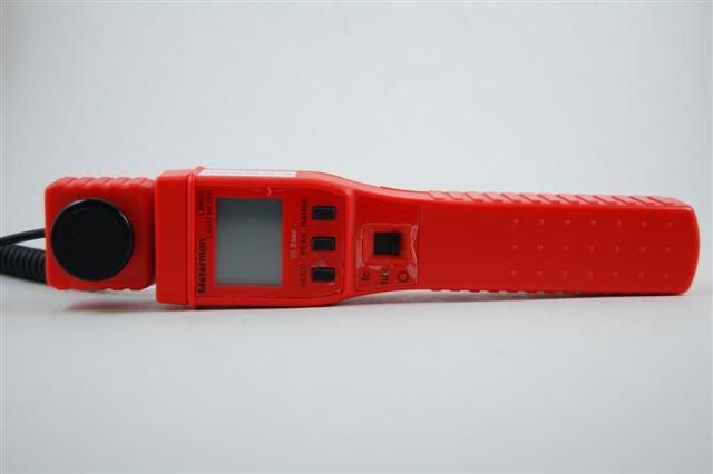

Look out!
It's a new Meterman Pic!   :D :thumbup:

Excellent! Did you get a lightbox? Great pics. Got any profile shots of the meterman too? ;)

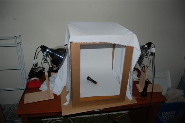

I built a simple Light Tent out of a cardboard box. I found these plans, Super Simple Light Tent.
The cloth material cost me about $9.00 at Walmart. You can use paper and glue it on the 3 cut-outs on the cardboard box but I wanted the option of removing the "diffuser" material so I just layed the cloth over the cut openings.
I bought 2 lamps at Walmart for $12.00.
I ordered 2 CFL (Compact Flourescent Lights, Spiral) lamps from a Bulb Supply Company on the internet for about $13.00. You need to to order daylight rated CFL's. Mine are rated at 6500 Kelvin. 5500 Kelvin should be OK to use. I tried the regular CFL's for household use but the pics come out on the brown side.
I found the cardboard I lay the lights on at Costco. It is scrap cardboard they use to separate the Charmin Toilet Paper bulk rolls.

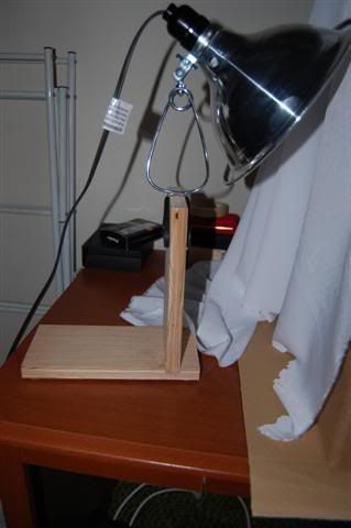

I built 2 stands out of some scrap Oak I had.
These are very simple stands I built out of scrap Oak.

Very impressive!  Both the light tent AND the various angles of that gorgeous, most-photo'd Meterman.  8)
