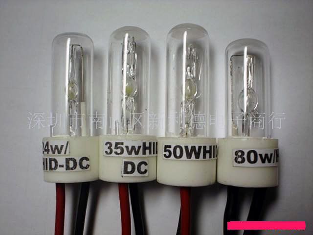

The Yellow Jacket light I have packed up for shipping tomorrow has a nice 4300k bulb with nice color and with lots of power. No 6000k bulbs for me!!!  I had the option of sending in DL-50 bulbs and sockets for these lights but there goes the cost through the roof. I figured the bulbs on the Yellow Jacket lights are very good so lets try there bulbs on the remote lights.
Shrouds are removed...
The ballast specs were for short start-up time and hot-restrike. The ballast specs were detailed so I left them to the engineer but to be guided by the most efficient and effective ballast to match up to the correct bulb...

I see the reflector is aluminum.  Any word on whether it's plated and if so, with what material it is.  Or is the aluminum highly polished?
7,000 Lumens seems a low rating for 100 Watts based on the Barn Burner being 8,500 Lumens at 75 Watts.

5400 for 65 watt
7000 - 7500 for 80 watt
9000  + for 100 watt
Watt may be total output so + or - around 10% which Ra should be able to confirm... Not sure how BB is rated...
I'll check on Reflector coating or polish...
