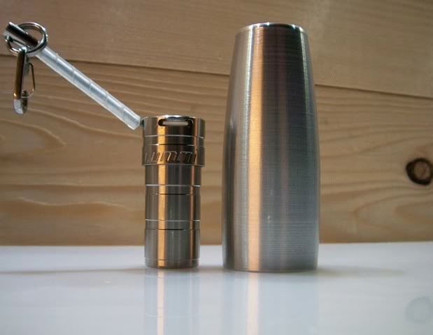

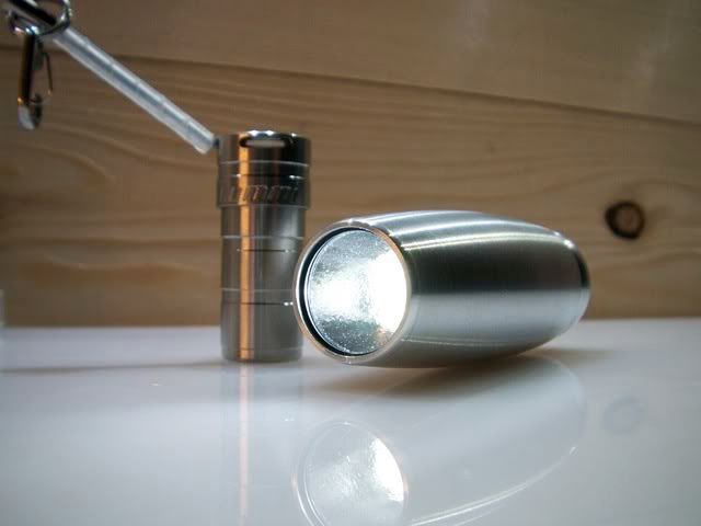

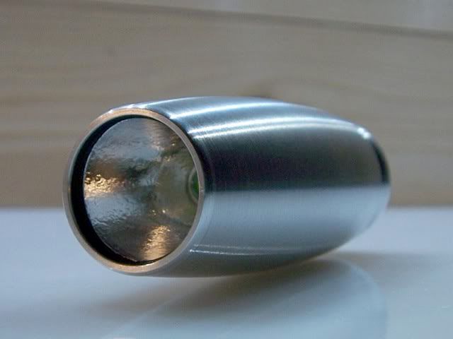

:wave: Guys. I am working on a new RCR2 / CR2 Aluminum light whose internal components are identical to the Alu Raw. I wanted to add more shape to the Raw which you can see I have done below.
The proto is 10mm to long & the drawings submitted to the CNC shop reflect this. So a production model will be 10mm shorter than what you see here.
Total length will be the same as the last Alu Raw we sold 57mm long. Diameter is a little bigger @ 22mm (The Widest point) Going down to 19mm towards the front.

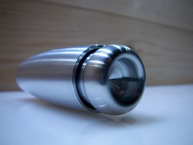

There will be the option of H3 Locators in the doughnut end of the light with lanyard attachment also.
There will be a milled logo & I may add some detail to the body yet.
It is a twisty two stage (15 Low 160 High) Cree XR-E Min Q5.
There are double O rings on the battery holder & a O ring Lens end.
The metal work for this new design is more expensive than the last Alu Raw which I did plan on superseding with this new light? Its looking like I should be able to retail the new design @ £45 (Not Firm Yet) with Nano charger & PRCR2. Locators would be the usual £6 each.
To sum up it could be the new Alu Raw? Or maybe the Alu Raw will live on?
There will be a 100 of Raw NS/Ti style made from Alu in March, These will have the milled Logo Raw Al, & will be the Lightest Raw Series made to date.
Photos below of the new Proto light.
Image above shows the actual length compared to a Wee Ti.
Feedback is appreciated as always  :thumbup:

Nice design, Rob.  :thumbup:  I like the clean, smooth lines.  Will you be making any of these in Ti?  Trit in the tail is better (IMO) than along the sides.  What's the donut looking thing on the tail?  How does it attach?

I want one but would have done the tailswitch so that it continued the silhouette of the body. That would conform to strict 'Steamline' design philosophy. ;)
