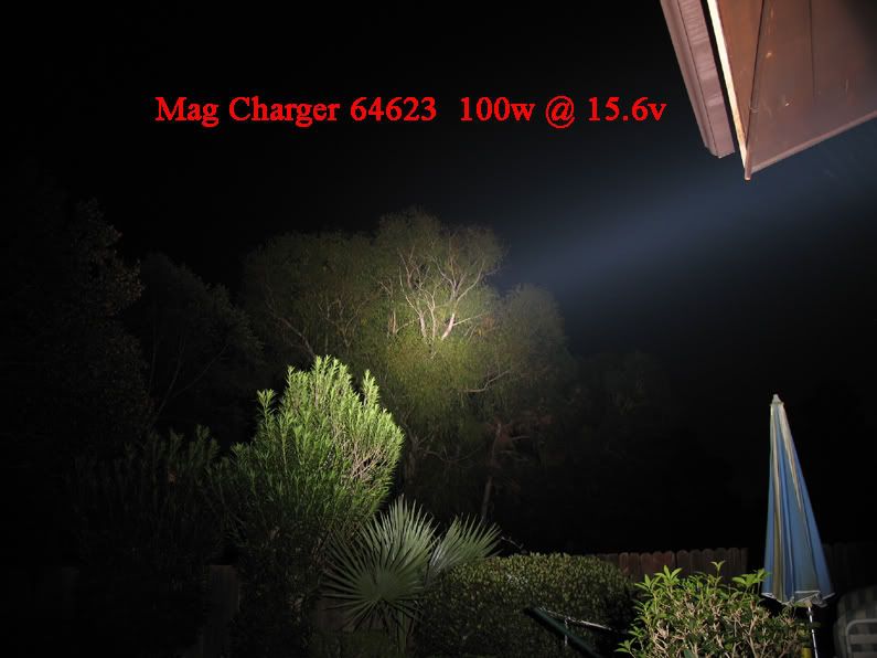

The difference between the 14.4v (12 elite 2/3A cells) and a 15.6v (1 additional cell) is amazing!
Correction, 14.4v pack had defective cells and the 14.4v shots are inacurate...
Full Manual Controls and a Tad Underexposed...
These shots will be brighter in person but the "difference" in brightness between shots is in the pics!
14.4V   (Torch Setup)
Huge difference that 1 little cell makes in output.    (Supercharge your Tourch!)

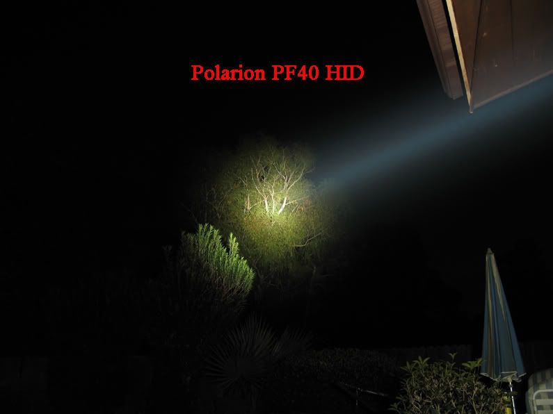

   HID and will run for an hour and a half!
Yes it's on!

Helios (1 hour 30 min runtime)  vs  64623 (Torch +) 100watt bulb at 15.6v (10 min runtime)
Helios (1 hour 30 min runtime)  vs  64623 (Torch) 100watt bulb at 14.4v (10 min runtime)

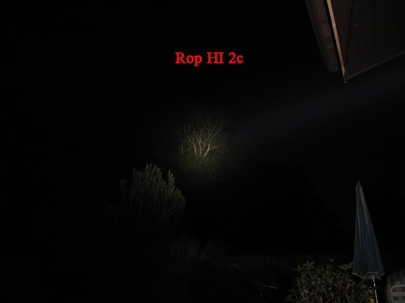

Helios (1 hour 30 min runtime)  vs  ROP HI 2 C (35 min runtime )  vs  64623 (Torch +)100watt bulb at 15.6v (10 min runtime)

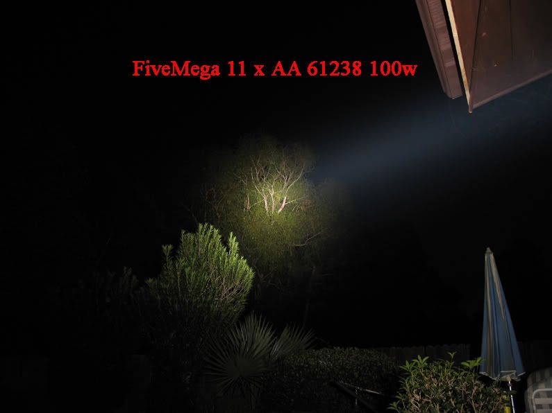

61238 (USL) 100w bulb @ 13.3v (10 min runtime)   vs  64623 (Torch +)100watt bulb at 15.6v (10 min runtime)
61238 (USL) 100w bulb @ 13.3v (10 min runtime)   vs  Helios (1 hour 30 min runtime)
61238 (USL) 100w bulb @ 13.3v (10 min runtime)  vs  64623 (Torch) 100watt bulb at 14.4v (10 min runtime)

Hey,        Aircraft800
That is one of Lux's new packs.
Although that pack will fry the 64623 100w bulb hot off the charger, the camera captured the incredible jump in output adding 1 cell makes for that bulb. It stays nice and white through a large part of the run too.  I had read it made a differnce but I'm a believer now!
Running these bulbs, close to the "limits", with soft-start will prolong the inevitable LED takeover someday...

Those shots have solidified my decision on a Polarion. Nice!
