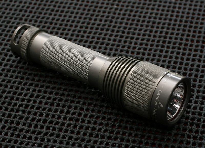

-Custom Heatsink
-3X "Q" bin Cree XR-E LED's
-Flupic Driver Each LED see's 450mah for approximatley 300+ lumens
-Bored for 18650 Cell
-UCL Lens
Next to it is a new Surefire I threw together with Q-Bins also :)

I like both, and really like the Surefire mod. Isn't the body a one-cell adapter for the M-class weaponlights? SW02, and an M3 strike bezel too. Yum! :thumbup:

Yes the LU10 is a one cell extender.
