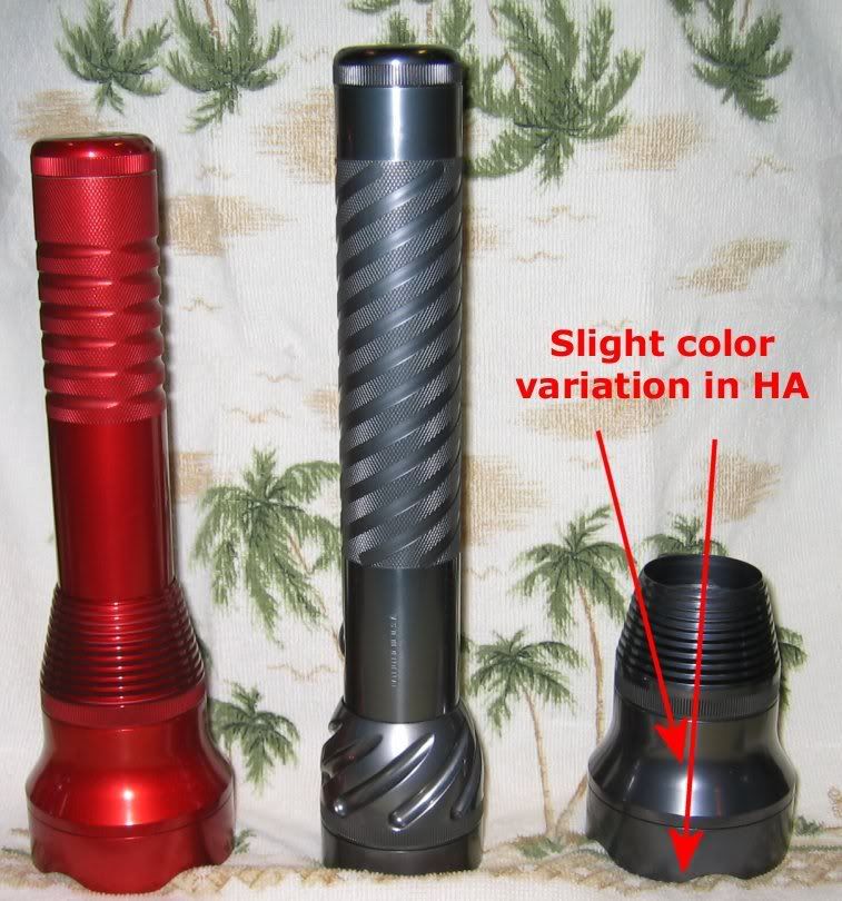

This is another very nice FM development.  The red looks the nicest.  The gray has a slight color HA mismatch between the two sections shown.  This gives very nice focus for hotspot and throw....slightly outperforming the 2" Deep.  There are two downsides, namely you can see with the red 1D that I made into a Mag85 how it screws onto the existing reflector base...in other words it replaces the inside reflector, and top bezel...which adds quite a length to the light...but it has a nice artistic curve shape, so helps.  The other downside compared to the 2" is this one has ONLY a 1/2" bulb bore, so for WA bulbs that is not ideal.
What this is REALLY OUTSTANDING with is the 75-100 Osram bulbs.  This includes the MaxBlaster, Torch, DeathBlaster, etc.  It gives outstanding hotspots with those lights, and eliminates the need for those heavily stippled reflectors they come with.
BTW, I'm using AW's new 3 x 17670-P cells after changing the battery holder to 3s that sold in this latest 1D sale to have a 1D Mag85.  It works perfectly with FM's stock spring, switch, gold bipin bulb holder...without any spring or other resistance mods.  I may put the old 2" Deep reflector on this to shorten it, do the tailcap spring mod, and use one of the 4 AWR Hot Drivers I have on this for better regulation.
