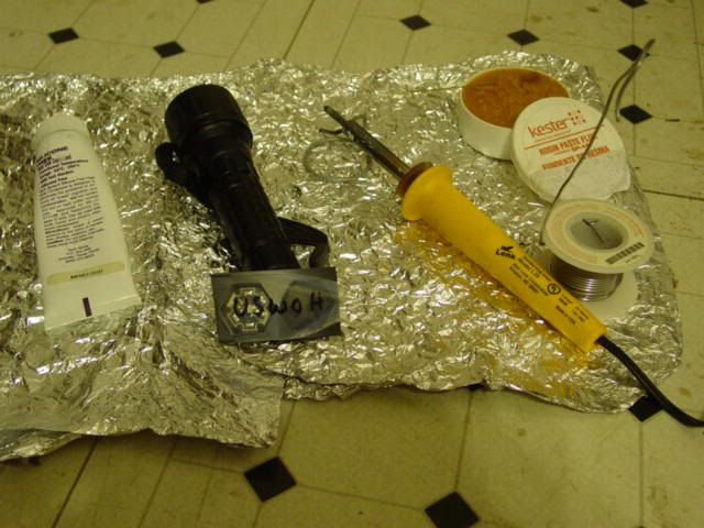

Let's get started with some tools and equipment.
The flashlight featured for this is a Nuwai TN115x with a 2 stage switch.

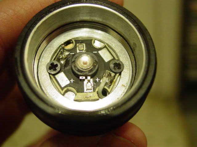

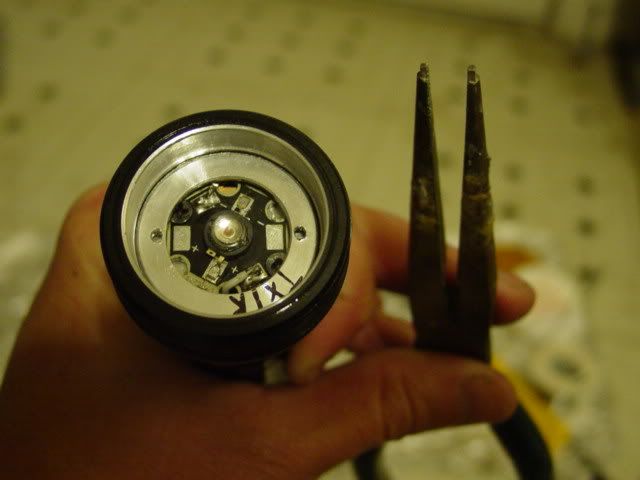

However, there is a retainer ring in there that needs to be unscrewed out before we can go further.
I used "needlenosed" needlenose pliers. Use anything similar that you like for this purpose.
Now we find 2 small black screw that are holding the star in.
Carefully unscrew those out with a proper fitting screwdriver, or screwdriver bit.
Done. :)

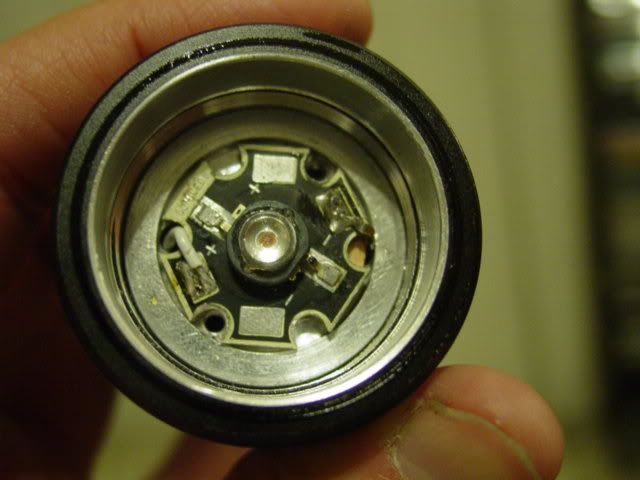

Now unsolder and lift up the wires from the star with a "pencil" type soldering iron.
Got it, but wait a minute...
Check this out, the wire on the (-) pad was not a wire.
It was a (-) ground tab.....clever. ;)

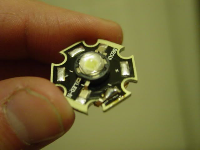

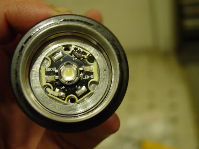

Here's the new led.
A top quality performing and top quality looking led. :)
We are now ready to do the reverse of the dissassembly.
We are halfway there!

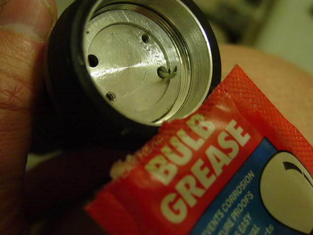

Put some rosin flux on the ground plate's tab.
Since the led (-) is coming from it's backside, we want a good electrical contact.
Bulb, or contact grease is used this time instead of heatsink thermal compound.
I have had good luck with contact grease just as much as thermal grease so far in the past.
Slide on the (-) contact plate and center it so it won't block the star mounting screws.
Solder the (-) contact tab to a (-) pad on the star.
Put some more contact grease in where the star is going.

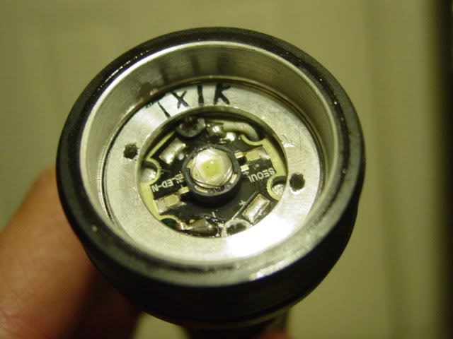

Let's put those screws back in.
If they were difficult to remove, use a magnetic screwdriver and lube the screws before putting them back in.
Done, but make sure that emitter and star are centered, or the light will have a crappy beam.
Loosen the screws and center the led best you can and then carefully retighten them.
Put the retainer ring back in.
Done. :) But not too tightly.

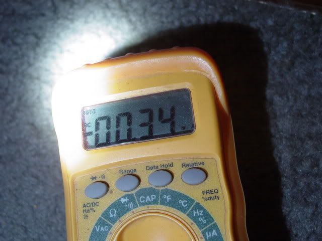

On high mode at 340 milliamps.
This is only 10 milliamps short of what the manufacturer of the led says it's designed to be driven at.
Certainly no issues here. ;)

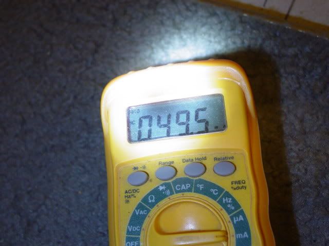

Low mode with 2 cr123 disposable batteries at 6 volts total this time.
Almost 50 milliamps this time for some reason, quite a jump from 18ma.
